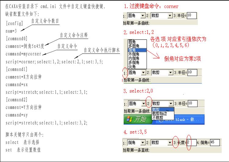

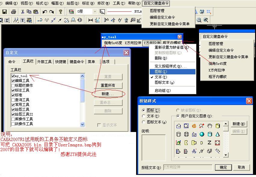

CAXA小程序能给工具条自定义图标,可以把CAXA隐藏的比较深的图库直接调出!
[config]
num=7
[command0]
comment=倒角5x45度
command=mycorner
script=corner;select:1,2;select:2,0;set:3,55;
[command1]
comment=X方向拉伸
command=sx
script=stretch;select:1,1;select:3,1;
[command2]
comment=Y方向拉伸
command=sy
script=stretch;select:1,1;select:3,2;
[command3]
comment=粗牙内螺纹
command=neiluowen
script=sym;select:1,5;select:2,1;select:3,5;
[command4]
comment=粗牙外螺纹
command=wailuowen
script=sym;select:1,5;select:2,1;select:3,7;
[command5]
comment=切线
command=qx
script=ltn;select:1,3;select:2,0;
[command6]
comment=法线
command=fx
script=ltn;select:1,3;select:2,1;
