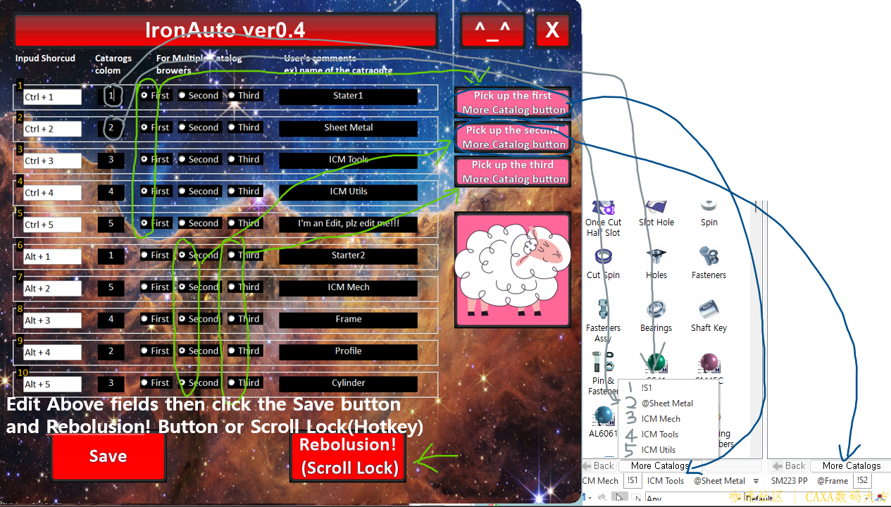

没有中文版,所以我还没有测试。请检查它是否有效。
- ICS -
Catalog Switching keys -> Set yours, and [ Save ], and [ Rebolusion! ] to use
[Left window key] : It will be remapping to Enter key (It's useful to press Enter only using the left hand in Chamfer or Blend tools...etc).
[Ctrl+D] : Toggle lock Scene's Smart dimensions and some 2D sketch's Smart dimensions.   <--- It only works on the English version
[ESC] : Escape from Drilldown Selection filter.   <--- It only works on the English version
[Ctrl+ESC] : Click Back button in the folder of the catalog browsers.
[Ctrl + `] : Switching Scene Browser<->Properties.

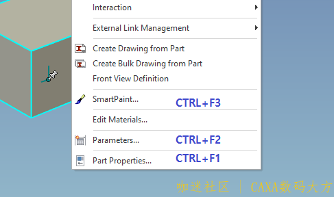

[Ctrl+F1] : open Properties under the cursor.
[Ctrl+F2] : open Parameters under the cursor.
[Ctrl+F3] : open Smart paints under the cursor.

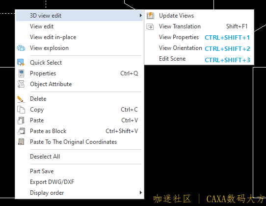

- CAXA -
[Ctrl + Shift + 1] : View Properties under the cursor.
[Ctrl + Shift + 2] : View Orientation under the cursor.
[Ctrl + Shift + 3] : Edit Scene under the cursor.
Note) Some functions only support 2018 White theme, DPI scaling 100% of the windows.
